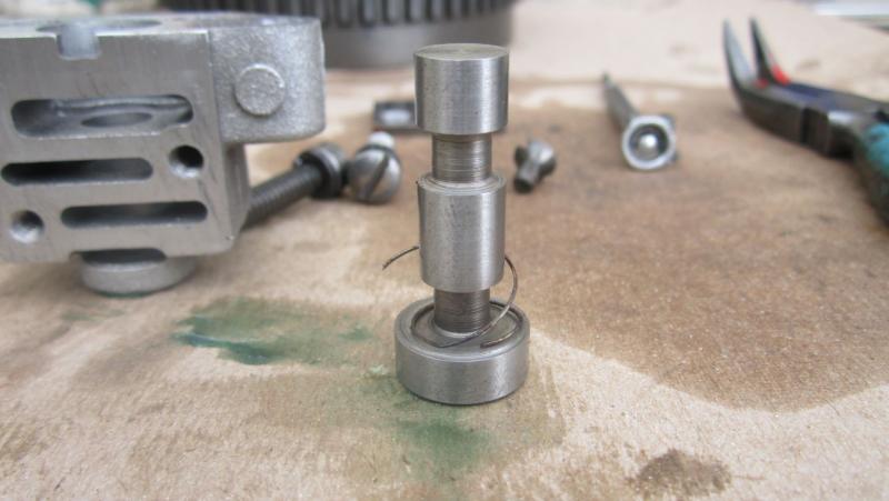

Thanks for the tips on the throttle valve! One of the shops said they fixed a 'sticky' throttle valve in there, but no change was observed. I have no way of knowing exactly what they did.
I pulled the valve out of the governor and made a new video. The piston has a very slight amount of side to side play. Could this be a possible issue with pressure loss? Moves nice and smooth without any roughness. Here's the video:
https://youtu.be/u06DsbFrAh8

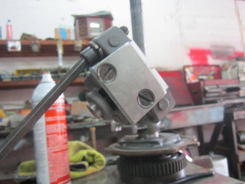

I think I might be onto something here. After watching a ton of tear-down/rebuild videos and looking at diagrams, I think the governor was installed backwards at the time of rebuild.
Here's a link to the video I made. Apologies on the quality. Working under a '57 bird without a lift is no picnic. I pulled the top part of the governor off previously to check the piston operation.
https://youtu.be/xWXLqUnh5Sw
If anyone can confirm that the governor is indeed on backwards, that would really help! Also if anyone has ever pulled a fordomatic tail shaft on a 55-57 thunderbird in the car — that would be good to know if it's even possible.

Just looked at your video. The spring is something added by a rebuilder to either compensate for worn governor or as a performance modification to do exactly what you are describing, late shifting. Reinstall it without the spring and your trans will shift normally. If the governor is worn the most noticeable consequence will be the trans will remain in high gear at a stop light and not change down until you start to pull away and fluid pressure is increased. Under this condition a helper spring can be used, but no where near as long as the one you have. A single tapered coil is plenty, and when compressed the wire should not lay on top of itself. (The spring under the float on a Holley 4000 carb is a good source from which to cut a coil)
ps the governor is installed in the correct position.
Dominic Hide is offline   Reply With Quote
Old 10-17-2020, 10:32 AM   #18
