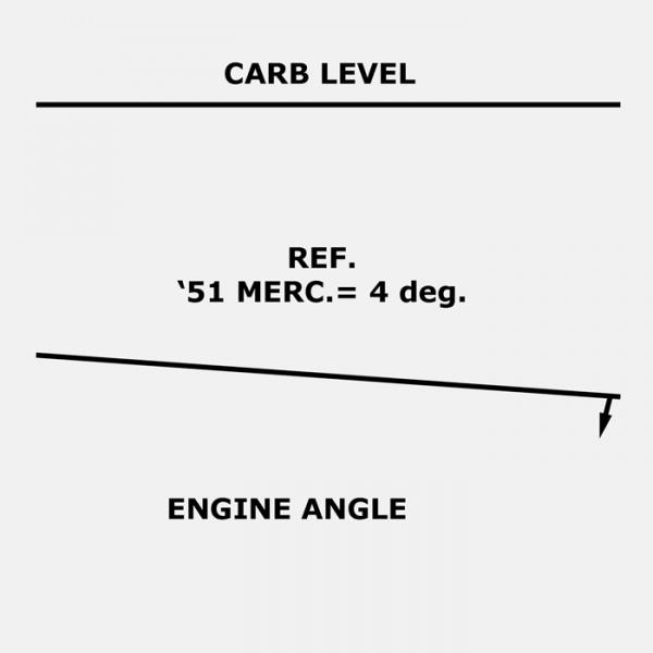

If your intake manifold has the built in angle to keep the carb. level, then use that angle to set the engine angle when the carb is level.
