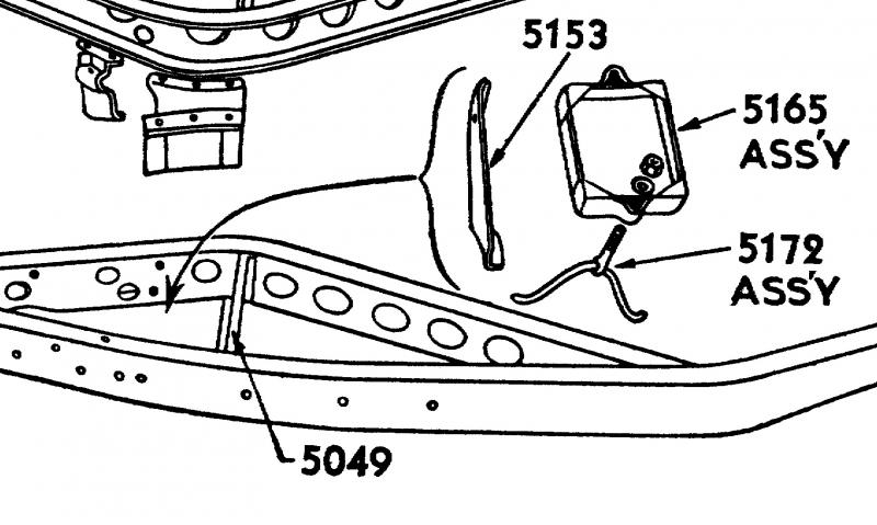

Piggybacking on this, can you also provide any information on battery hold down hardware for a 1936 Phaeton ?

There is a detailed description of the hold down hardware in The V-8 Clubs 1935-36 Ford Book pgs 94-95

Don,
Except for the two upside down Vs with tails with threaded ends that secure the rectangular perimeter on top of the battery, the battery's position and how it is secured also shows up pretty well in your photo in #2 above.

Here's the photos from pages 94-95 in The 35-36 Book as well as a closeup from the photo above.
