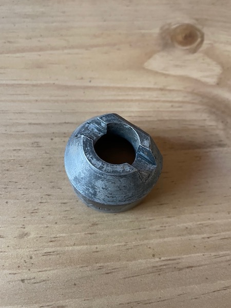

Or track one of these down. They're made to use the crank in either direction.

What part or where does it not fit? I have one too. It works great, but is a tight fit to get it in place. Maybe yours just needs a little grinding for clearance somewhere.
