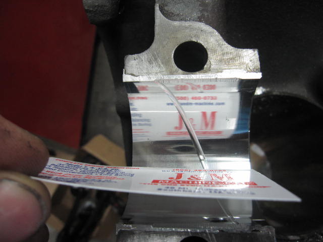

Question: Does anyone out there DEFEND THE THEORY that oil grooves are not needed in Model A engines and did Henry use them? Does anyone cut the grooves in before they line bore?
Pick a question and answer it if you please. No I won't say who the builder is in an open forum and will only give my own opinion of who I would not use again if asked in a private message.[/QUOTE]
IvoryJohn: We feel for you. We got a customer like yourself in today.
You'll see in picture one worn out with about 700 miles on it.
This poor workmanship is happening more often it seems.
The grooves are there for a reason and serve an important purpose. Ford had a whole design team that engineered this engine and those grooves are there for a reason as is the oil wells.
FORD being the perverbial thrifty shrewd business man would of deleted them and saved 1 cent if he could have just like a lot of other parts on the Model A but they're there for a reason.
We would also like to know who said that you don't need the oil grooves? It's that Fifth column again.!
Adding the rope and cork is clearly amateur night.
