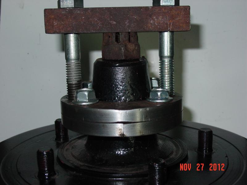

This is the one that I made like the one pictured on ebay. It works real well on Model A and also on the 40-48 Ford rear hubs.

I'd suggest turning that axle nut over before applying pressure on it.

Originally Posted by katy View Post
One option is to back the axle hut off about a 1/2 turn, re-install the cotter pin and drive around the block.
Another style that works good:
This is the hub puller I used. Works like a charm.
