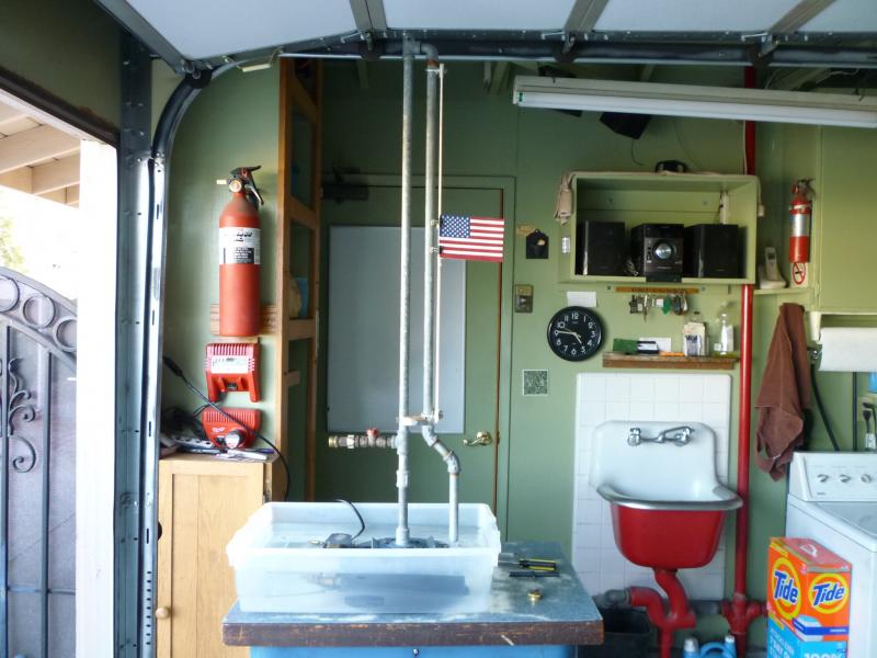

Here is my flow tester. Does not need any pumps, pvc pipe etc. Just an old milk carton, rubber tubing and some plywood. It is just as acurate as any other but simple KISS.

Attached photos are of a jet flow test stand I built a number of years ago and have used continually. It has a 36" water column. The pump is a water fountain pump obtainable from Home Depot. To mount the jets I purchased some water faucet blank screw-on devices and drilled and tapped them A valve is included to turn the flow to the jet on and off. The water column is mounted to a discarded Model A brake drum.
