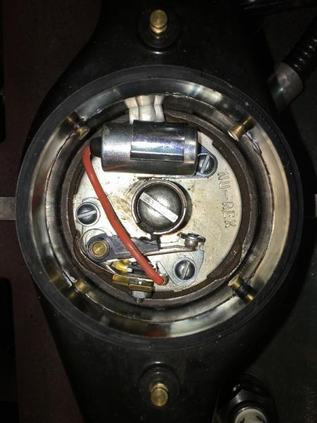

OK, the Nu-Rex upper plate is pretty easy to time visually with a B distributor cam. At TDC, looking down from the top, the upper edge of the cam slot should align with the lower edge of the rubbing block as illustrated with red lines in the attached photo. This will position the points just barely closed and they'll open in the next instant as the rotor turns CCW.
This advice applies only to the Nu-Rex upper plate, the stock plate looks different.
