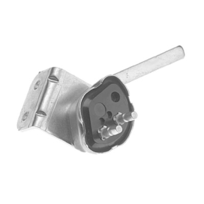

I've had countless hydraulic switches fail in recent years. I've been using GM style lever switches on the bottom of the toe board. Napa SL129 or BWD S191
These are great switches....THEY WORK! Simple as it gets. Here is a picture of the switch mounted to the Ford's wooden toe board, with the brake pedal resting against the spring-loaded arm. DD

Why fool around with those crappy hydraulic switches when EVERY decent parts store has the mechanical switches that A.Stud and Coop are showing pictures of?
There is a right hand switch and a left hand switch.
Either one will work on most pedals tha pivot below the floor.
I have one on my F1, I have one on my ‘48 Nash Ambassador and one on my ‘29 Nash and one on my ‘26 Model T Ford.
I also have two new spare switches. They are STANDARD SLS40 and STANDARD SLS43.
One is going on An MGTD that I am restoring an updating.
I can not be bothered with hydraulic switches, sespecially since my cars have DOT5 fluid.

There has to be a reason cars have not come new with a hydraulic stop light switch for several years. They’re not safe!
The old Chevy/GM switches are easy to mount and wire.
Just two small screws or bolts through the floor.
