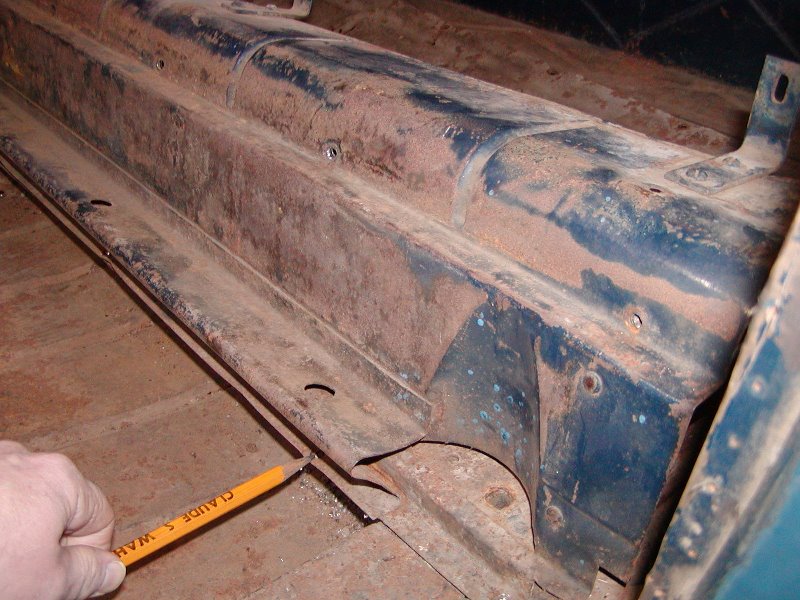

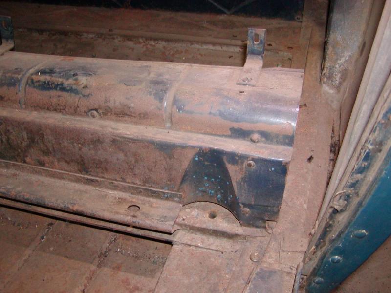

CWPASADENA: here are some pictures of the floor in my 31 Roadster when I was removing it. I hope they help. Notice the 3 semi-hidden rivets under the seat backrest riser (pencil).

SJARK,
Thanks so much for the GREAT pictures. This is a big help.
And, thanks to all who responded. This is a great part of "The Barn".
