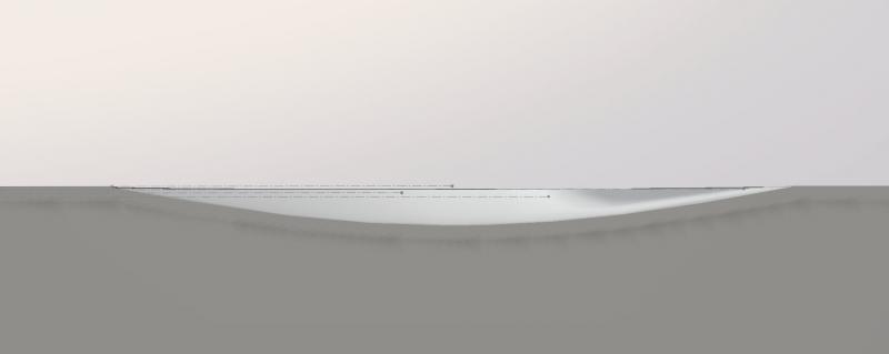

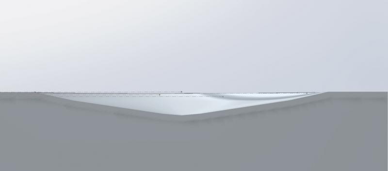

Originally Posted by flatjack9 View Post
I've used Sealed Power, but I'm not real crazy about the shape of their dome.
Do they use the "ellipse" style dome - pointy in the middle? I've seen this dome on some Egge pistons, some 4-ring Jahn's, and some Ford.
If so, then these pistons will not work with any of the aftermarket aluminum heads (which use a consistent radius dome) - the "pointy middles" will hit the heads if the squish is anywhere close to what it should be. The squish should be .040 to .050 for optimal performance.
This is the reason that I always try to find a consistent radius dome type piston - if using any aftermarket heads.
Here are some pics of the double-ellipse style domes shapes versus the consistent radius dome shapes that are on Ross pistons, Edelbrock heads, etc..
Here are the pointy domes - the shape necessary for the heads to work:
Here are the consistent radius somes - like Ross Pistons (again from the head dome perspective)

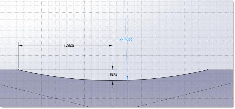

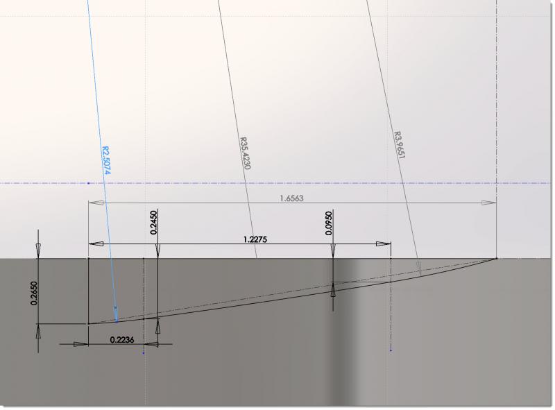

Here is the actual 2D sketch view that I use for 3 5/16 pointy pistons (when I machine the heads in a CNC mill)
Here is the Ross sketch I use:
Old 06-30-2021, 07:42 PM   #7
Attachment 467081
Attachment 467083

The dome does not extend to the edge of the piston. There is about a 1/16" flat before the dome starts.
