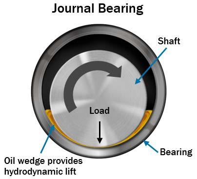

Main bearing nuts, $2.35 a pound at the industrial salvage place.Metric hard washers opened to slip fit with a die grinder.Dab of triple bond on the block side,blue loctite on the threads.Grip length of rod bearing nuts is important but not overriding,the hydrodynamic principle protects the rod bearing assembly,it removes shock load and heat,the fastener is not subjected to undue stress in street applications.
there is magic in a thin film of oil..
