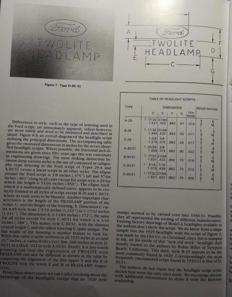

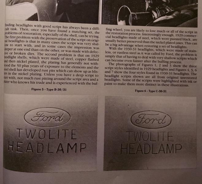

Article from How to Restore Your Model A Vol 4 pg88 by by E.Kline and Marco Tahtaras
