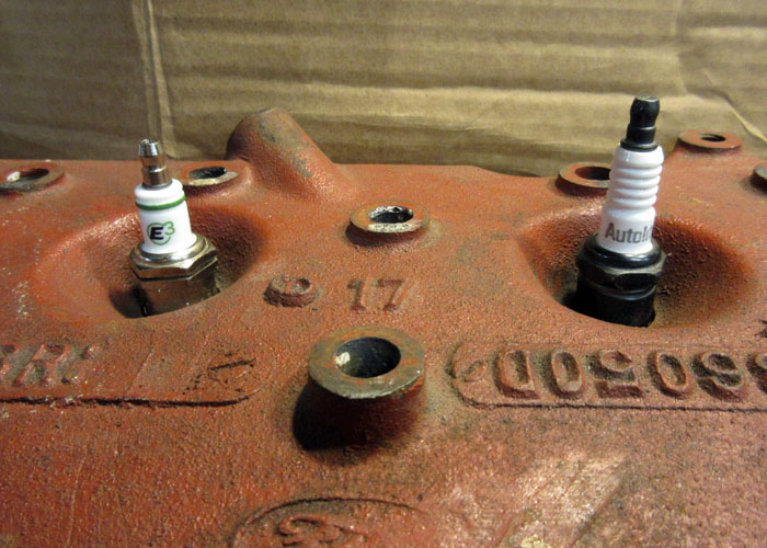

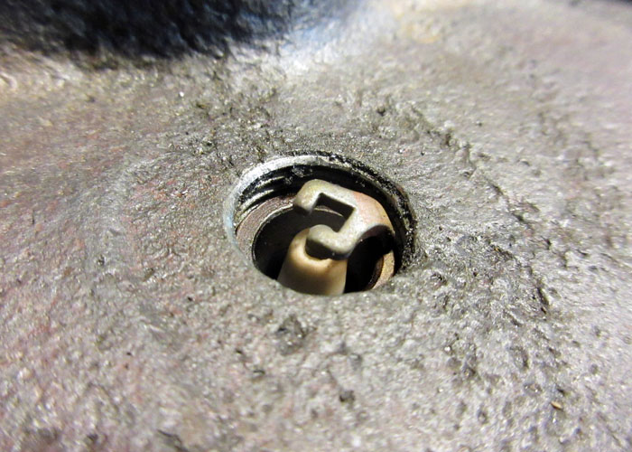

Default Spark plugs, another option?
Replaced the 216's with a set of E3-10's about 500 miles ago. Although they have a slightly shorter reach, the electrode extends .025 farther into the chamber. They are 'stubby' plugs but that is no problem. The thing that I have noticed is that there are better cold start and idling characteristics.

What is the part number for the ones that you are using? Bill

E3-10 -Revised the original post.

Interesting. Do you know what the original application of this plug was? (I used marine surface gap plugs with great success in an 8BA with Offenhauser heads.)

That plug is very hot if the crossref is right equal to a NGK 2/4 heatrange original is 6.
Says its some magic fuelsaving plug for lawnmowers.
No problems while driving it hard ?

Have no idea what the application is but probably for a lawn mower engine just like the Champion H-10's.
For Offy heads, because of the longer reach, you would have to search the E-3 spec. sheets for thread and reach size.

Kind of reminds me of the Lodge 4 prong plugs for Alfa Romeos used. Always wondered if the spark would hit multiple electrodes or does it give the spark more chances to land if dirty or fouled?
