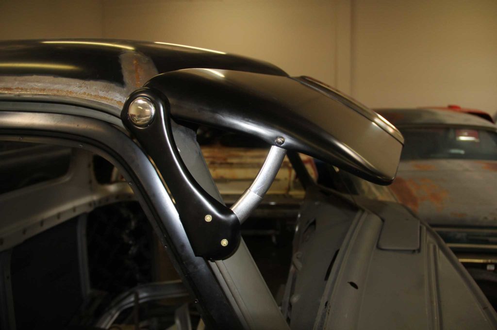

Like this?

Yes sir, that is it. I appreciate the help. Do you know about mounting screws? There are four on each side that attaches visor to vehicle. I think they attach to the rain gutter rail but can’t find out if it mounts to side of rain gutter - inside or outside of rail. Are the screws the self threading type or do they have a nut?
