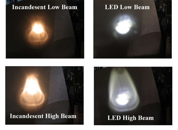

Here is a picture which compares the focusing of LED vs Incandescent bulbs. The pictures were taken with a clear plexiglass lens. The adjusting screw was adjusted to give the smallest (most concentrated) pattern.
Judge for yourself.
Bob Johnson

Bob, Are these the lights shined on a flat wall or did you stand in front of the car and take a photo of the headlight? Nice work, by the way. I would be interested in the view from the front seat with both lights illuminating the road ahead with the normal lenses in place. You may have to use the same exposure time and f number to get an accurate comparison. Not sure how to do that with a modern electronic camera.

The lights are shining onto a piece of cardboard about 3 feet in front of the car. The intent of the pictures was to show the focus of the bulbs and not the intensity so the exposure is not relevant.
