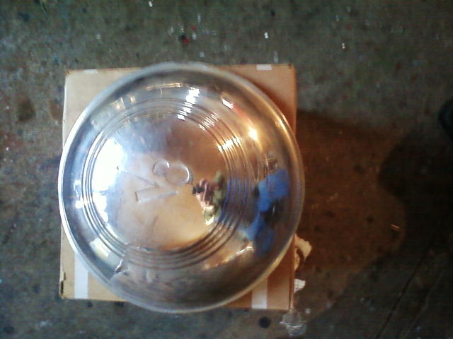

I am looking for help identifying the proper hub cap for 39 Standard Coupe. My car came with 3 that I assume are correct but I wish to confirm before I put a lot of effort into completing the set. Also, I would also appreciate suggestions for sources.
I have attached a photo (apologize for poor quality) of my hubcap which measures about 11 1/8 inches in diameter. Many thanks! |

Screen Shot 2018-01-09 at 2.30.35 PM.jpgAttached is a photo of the correct hubcap for 39 Standard

Be careful! 1939 standard hubcaps have been repro'ed for a long time. The chrome plating is not the best. Original 1939 standard hubcaps were made out of Henry's rusless steel. Nice ones are hard to find. Old posts will show the differences.

The pic you supplied looks to be a 39 Deluxe hub cap. The pic supplied by 30six shows the 39 standard hub cap.
Sometimes can find them on Ebay. Took me about 2 yrs to locate a 38 standard hub cap to complete a set. All the best. Phil NZ |

This is the correct Hubcap for the 1939 Ford Standard model. Notice that it has a small V8 in the centre. |

This is the correct Hubcap for the 1938 Ford Standard model. Notice that it has a large V8 in the centre. The V8 is similar in size to ones on the 1938 Ford Deluxe. |
