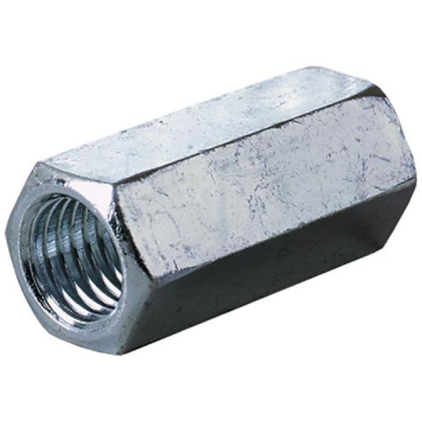

These posts include lots of well-placed concern about the strength of the threaded components and possible failure. Solutions include Grade 8 threaded rod or Acme threaded rod, and coupling nuts or Grade 8 nuts instead of common nuts. All are readily available at McMaster-Carr or other industrial supply sources.

Rather than C-clamps I prefer to use spring to cross-member clamps themselves to hold things intact while removing the center bolt and installing the threaded rod. Somehow don't totally trust C-clamps. I also prefer to use coupling nuts above and below the spring. They will turn easily even with the toughest spring such as a Model A rear. |
