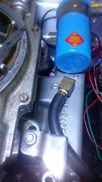

I was checking spark plugs today and the #4 and #8 plugs are showing a lean condition, very white. I've recently replaced the intake gaskets when I resealed the valve chamber cover, so I'm confident that it is OK. I do have a 7" power booster for the brakes connected to the top of the intake manifold behind the carburetor. I'm wondering about the possibility of the booster leaking. The brakes work good, with the exception of there is no reserve if the engine stops. There is no external vacuum reserve.
How can I check the booster? Should it hold a vacuum if I pump it down with a MityVac? The engine is a 272" Y block and holds about 17-18 vacuum. The possibility of a vacuum leak just hit me tonight and I would like to troubleshoot it tomorrow. I think I'll start by plugging the booster fitting and see if the engine vac goes up, and trying to pull a vacuum on the booster. What are your thoughts?

I just went to the shop and pulled a 20" vacuum on the booster and it took 35 seconds for it to drop to 15". I wouldn't think that would be a serious vacuum leak. I put a wrench on the manifold bolts and none were loose. Tomorrow I'll warm it up and pull the plug wires on those cylinders and check for RPM drop

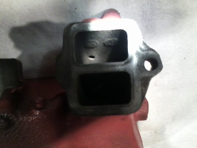

Is the intake manifold an ECZ-B, or something else?
Look for vacuum leaks with a spray of starting fluid, WD-40, etc.
Are there other vacuum lines to the fuel pump/wipers & heater? Check those too.
The fitting in the intake manifold may be cracked, or there can be leaks in odd places.

Thanks for the "odd places" suggestion and example. The manifold is an ECZ-A. I tested the booster at the engine end of the hose, so that only leaves the fitting and threads suspect in this vacuum circuit. The only other vacuum connection on the engine is the distributor vacuum at the base of the carburetor.

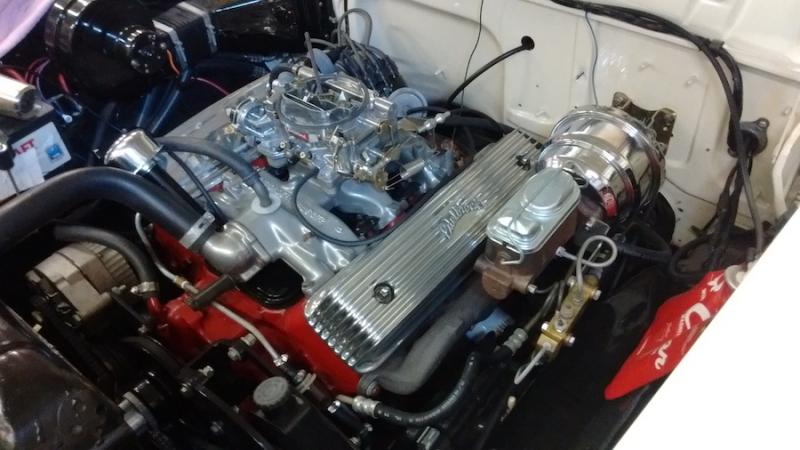

Cam we get an overall engine photo?

Yes, 1959 distributor. Manifold vacuum. No 2 stage pump, electric wipers. Manifold vacuum is 17-18 inches measures at a tee in vacuum advance line.

KULTULZ mentioned a drilled/tapped vacuum source. I looked up a picture of an ECZ-A manifold and, sure enough, no fitting in that location. I found a plug in the rear of the carburetor and moved the brake vacuum to a fitting I installed there. Engine vacuum is a steady 19 at 600 RPM, though about 14-15 at 400 rpm. I keep the idle RPM at 600 so as not to kill it with the AC on. I guess I'll drive it a while and recheck the plugs. Thanks for the interest and suggestions.

You are ahead of me again ...
OH!
Nice looking install...
