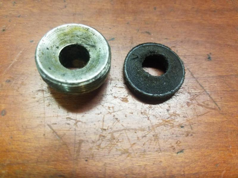

I am rebuilding my 7-tooth steering column and wondering
how the oil seal retainer with tube is installed. The old oil seal retainer
shown in photo 1 had a rubber(?) washer/gasket above it. Photo 2
shows what I received as a gasket set and I am wondering about it.
Where would the 0-ring go? Is there an oil seal that would work with
the new oil seal retainer with the tube? Should I re-use the one in photo 1?

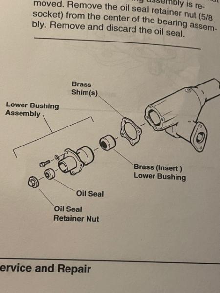

this work
www.whidbeymodelaclub.com
Gary WA is offline   Reply With Quote
Old 07-18-2021, 05:15 PM   #13
walkerlakeprinter
walkerlakeprinter's Avatar
Location: Walker Lake, Nevada
Posts: 304
Default Re: 7 Tooth Help
I have seen this illustration, but I didn't notice where it says "Remove and discard the oil seal." I still can't figure out what the felt washers in the gasket kit are for. I seem to have ordered two kits in the past, but so long ago I can't find the invoice and don't know where they came from. One supplier shows a kit that has the paper gaskets and one that looks like the oil seal I removed. I'm guessing I will put everything back together without the added oil seal and just seal the threads on the new oil seal retainer with the tube.

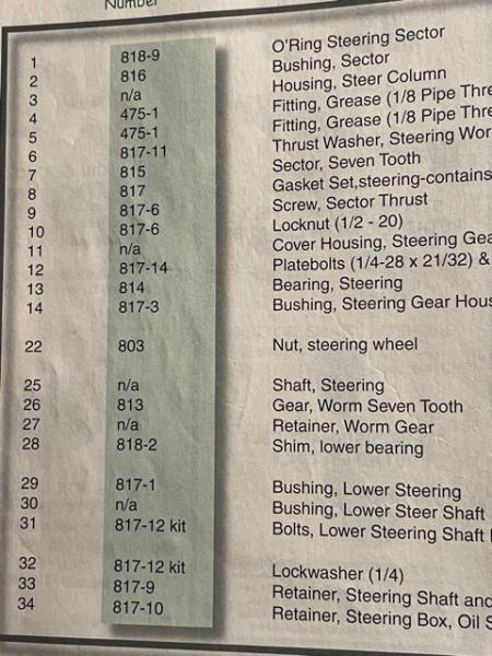

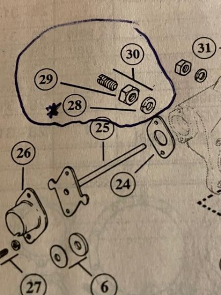

O Ring is for the steering sector-Number 1,cork gasket is for steering box oil cork seal at end plate,for original style end plate.The steering shaft felt retainer/with tube to prevent leakage number 34

I just discovered that the new oil seal retainer will not fit for me. I didn't check
the inside diameter of the steering shaft. The old retainer will have to do. Maybe the shaft on the column I am removing from my 1929 Coupe will have a different shaft.
