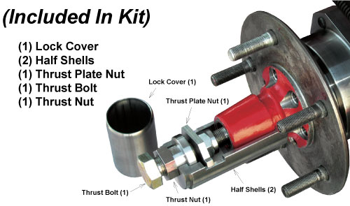

Is this correct for 36? It doesn’t fit on my 37. Bought it years ago for a 36 but never used it.

Rock, that’s what I thought when I bought my puller but it doesn’t fit my 37.

The Vintage Precision will, I've pulled my 32 Ford & 39 Mercury with it!!! Works swimmingly, Fixing to use it on my 47 Mercury here shortly!!!..... AS advertised "28-48"

Roc, do you have a photo and the measurements of the opening? Thanks!

Here is a photo from vintage precision's web page, as you can see, the cap that screws onto the axle end and you push against, has a long slot that it can slide in for short OR long snout hubs!!!!! As it states, it will pull from Model A's to 48 V8's!!!!

The New Vintage Precision hub puller will not work on a hub that has a protruding ring as my 37 has.

I had that problem on my 38 too. I called them and they recommended sanding off some of the surface roughness on the ring. Worked like a charm.
