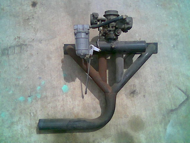

Here are some pics of one of the best 2 carb manifold designs I ever came up with. Excellent instantaneous throttle response and better than stock gas mileage. Uses 2 Ford single throat Holley carbs. Very easy to fabricate also.

This was made in the late sixties with standard U-bends, tube, two steel freeze plugs, a steel strap, a one-piece manifold gasket for a pattern and a welder that couldn't. The carb is a holly one barrel.
