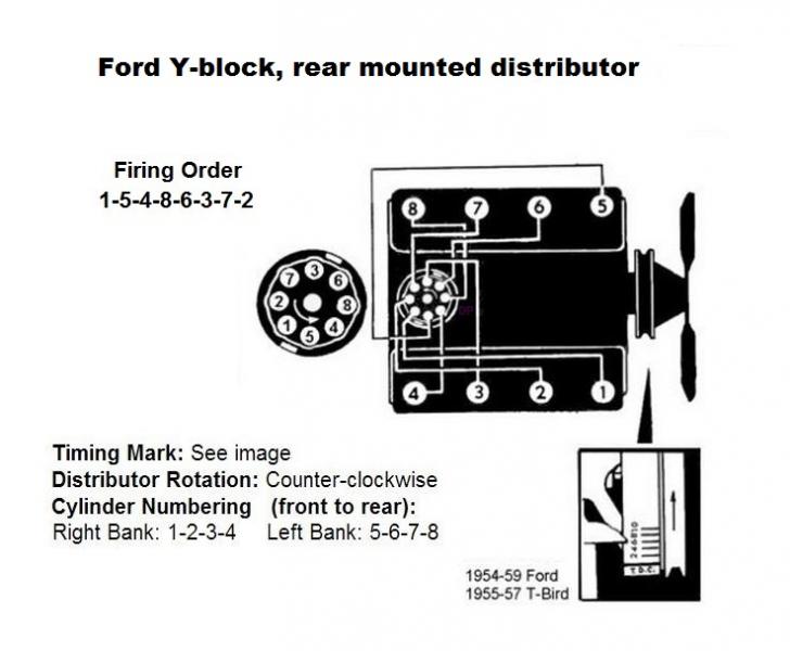

You're able to easily rotate some of the valve springs? That doesn't sound right...
There should be 71-79 lbs of spring pressure holding the valves shut. ('57 shop manual pg 1-31) Valve adjustment procedure. Are you sure the TDC mark on the crank pulley hasn't slipped out of position? Attached photo #1. On many Y-block pulleys the outer ring with the timing marks on it is rubber mounted and can move when the rubber layer begins to fail. Here's a Tim McMaster valve adjustment video that's not dependent on finding TDC on the crank pulley. As mentioned below by Crankster, with this version you can do the cylinders in numerical order, front to back, one side at a time. Not skipping back and forth from one side of the engine to the other and losing your place. CRS https://www.youtube.com/watch?v=SqG-Q_kVI3s Another of his videos, in case you prefer this method. https://www.youtube.com/watch?v=PIB9m1Kp61o . Last edited by dmsfrr; 06-30-2021 at 10:51 PM. |

Crankster is correct, in that several manuals have the firing order printed wrong. some have the FE firing order, not the Y-Block firing order. If the firing order is cast into the intake , use that.
