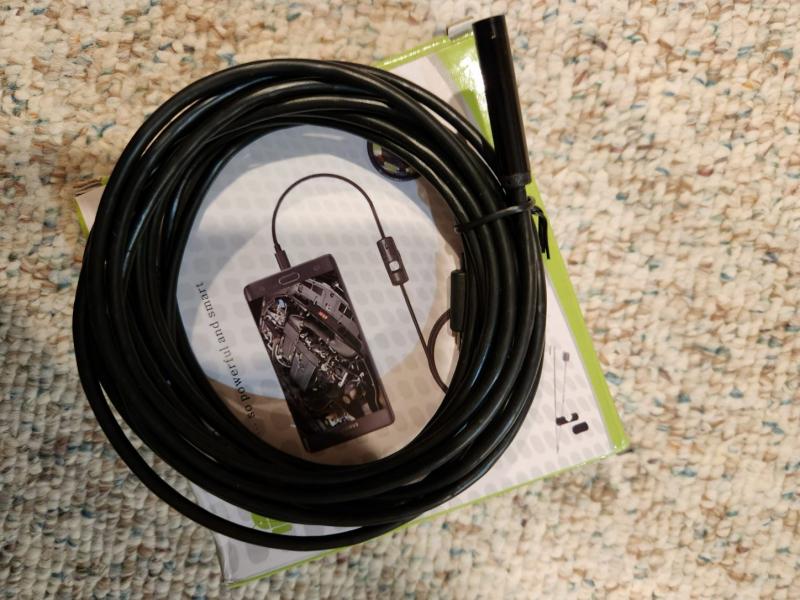

I got one of these from Amazon a few years ago. It might be small enough to fit in the spark plug hole & turn in to the cylinder bore.

Pic of the back of the box.
