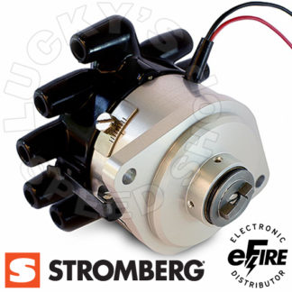

Am trying to gather some feedback on this Stromberg electronic distributor.
Does anyone have any experience as the the quality and reliability of this item?
Sure is pricey. Thanks, JIM

$410.00 at Summit Racing

tubman: THANK YOU very much for the excellent feedback on the Stromberg units.
petehoovie: Thank you for posting the big photo. Really helps.

they seem to be a love/hate item some love them others hate them it appears that a lot of problems relate to installation and other associated items [ie electrics condition ] the install direction need to be followed to the letter as they are not forgiving [what electronics are] but at least spares are readily available

My concern here is tuning. Without a vacuum signal, How can the ignition timing be controlled for loading conditions of the engine. Did I miss something

No, you are right.

Ron and flatjack: (in purple)
Here is what the tech. info. in the Stromberg add says. Does it make sense in relation to your valid question re: tuning the Stromberg E-Fire Electronic Distributors
They make it sound like you just "dial it in" on the distributor using their timing adjuster on the side of the distributor. Does that make any sense?
Here's the add:
Stromberg E-Fire electronic distributors actually look like they rightfully belong on your traditional flathead motor. They feature a simple, built-in electronic ignition. No points, no condenser, no black or red box, no maintenance--no worries. These crab-style units bolt on like a stocker with a black cap, and they're easy to properly install with just two wires to your regular coil. Order a Stromberg E-Fire electronic distributor for your Ford flathead and bolt it on—it works straight out of the box!
Features and specs:
* 2- or 3-bolt mounting options available to match your application
* Available in your choice of 6 V positive or 12 V negative ground
* Designed as short as possible with hot rod builders in mind, so you can use the stock fan
* Timing adjuster is on the side, so you don't have to turn the whole body
* Static timing, advance rate and max total advance specifically tuned to suit the flathead V8
* Old-school performance tag with a unique ID number
* For use with a points-style 1.5 ohms coil only

I have a 6 volt that has about 2 miles on it. It is now in a box. I could not get rid of a miss as the rpm increased. Talked to the guys at Millwood and they suggested to adjust the carburetor, I did, no luck. Sent my old helmet to Skip Haney, runs like a top. I was thinking today that I would get in touch with Stromberg and send it back to see if they get the miss while it is on their machine. It could have a defective module, I have no idea. The general problem with electronic distributors is (I hear) when they quit, they quit, no limping home. When I was inquiring of the "Barn" about the Strombergs, I got garbage cans posted in replies. Not very helpful. Some people have no problems with them. Others . . .

I have 1 on mine and no troubles.Had a Mallory and had trouble after a few years.So I went with the Stromberg.

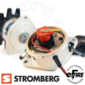

I purchased one of the early E-fires before they added the small clip to keep the wires away from the rotor. It ran great, but then the wires rubbed and it shorted everything out.
I reached out to them and they stood by their product. I was able to send it back in and they rebuilt it and returned it free of charge. I haven't put back in the car yet as the stock distributor is working well. Will probably put back in over the winter.

I fitted one to my 59a in my 32 roadster... ran perfect, just make sure you use the right coil, he leads etc.standard leads will not work properly.
