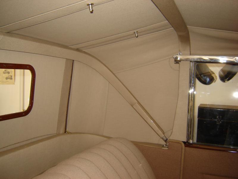

bows have been covered in many ways
here is the right way

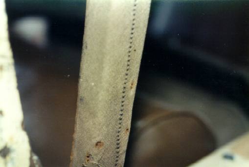

This picture is the original stitching on the bow. As Marco says the material is diagonal cut. The material needs to be cut at 45 deg rather than straight across the roll. The resulting tube of material acts like a Chinese finger and gets tighter as you stretch it's length. As I recall LB does not normally supply enough material to cut it on the diagonal.

Posts: 619
Default Re: 68B top install questions
Yes it is the #2 bow and was stitched full length. The original cover was no longer on the main bow so no guess at it. I ordered extra fabric so I could bias cut the bow covers. I cheated and just stapled the fabric to the bows on the side where they had originally been stitched. The vertical portion of the main bow was covered over cardboard like a door panel and was not bias cut. It was nailed to the wood and over lapped the ends of the upper cover. Don't remember any problem getting the main bow cover tight but that was over 20 years ago. I may still have that bow upholstery as I do have the original seat, rumble seat and door upholstery as well as some other pieces. It was well preserved under the vinyl that shows in the picture. I never did get any fabric from LB that matched the original package tray. I have a number of pictures but not of the original upholstery. Pre digital camera era!!

Q3 : Does the stitching in the photo posted by Jerry Parr, constitute the seam where the material is sewn to form a tube ?
