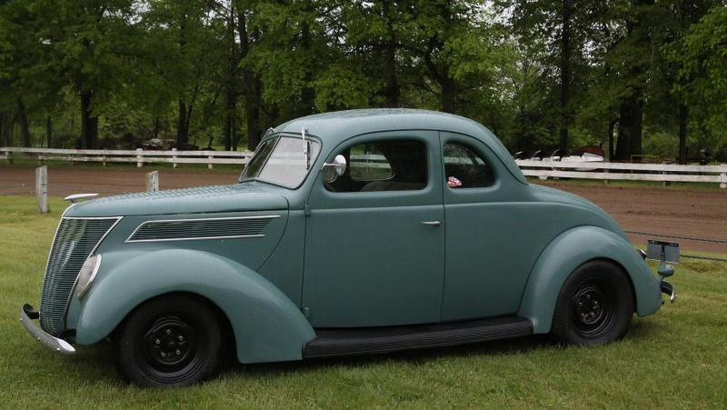

Here is mine

This car I built has a 1-1/2 over stock dropped axle. Durant mono leaf reverse eye spring and F100 brakes. Sits right and stops great. Has 37-41 spindles with stock steering arms that did not need dropped. Chassis engineering tube shocks and a custom made Panhard bar. F100 brakes are bendix type with 5 on 5-1/2" bolt pattern.
File Type: jpg 13227753_10208646425974017_3416068124444886444_o.jpg (61.9 KB, 422 views)

Originally Posted by skidmarks View Post
nice looking '37
tony-starr.com
Looks like picture may have been ttaken on a rainy day at Latimore Vally, PA

Originally Posted by tony starr View Post
nice looking '37
Thanks. Got a flatback to do next basically the same way.
