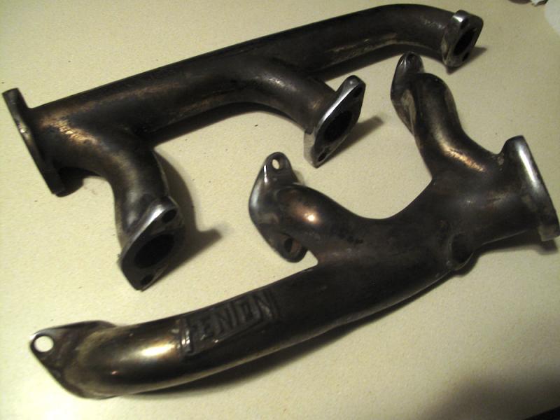

A old set of used dirty chromed fentons I have, still okay. New casings are a bit different. Just need to find a short block 59ab.

The "old" cast versions have a thinner cast and design. So believe me or not, it was common before knowledge. I don't care. I'm not selling anything. The repops are not the same, but do work well with little amount of work on the driver side manifold for some applications (sometimes they bolt right on), but maybe not all applications (no big deal, a 10$ mill and a little dremel grind around the dip, there is plenty of meat there). Just a personal preference and like them.
