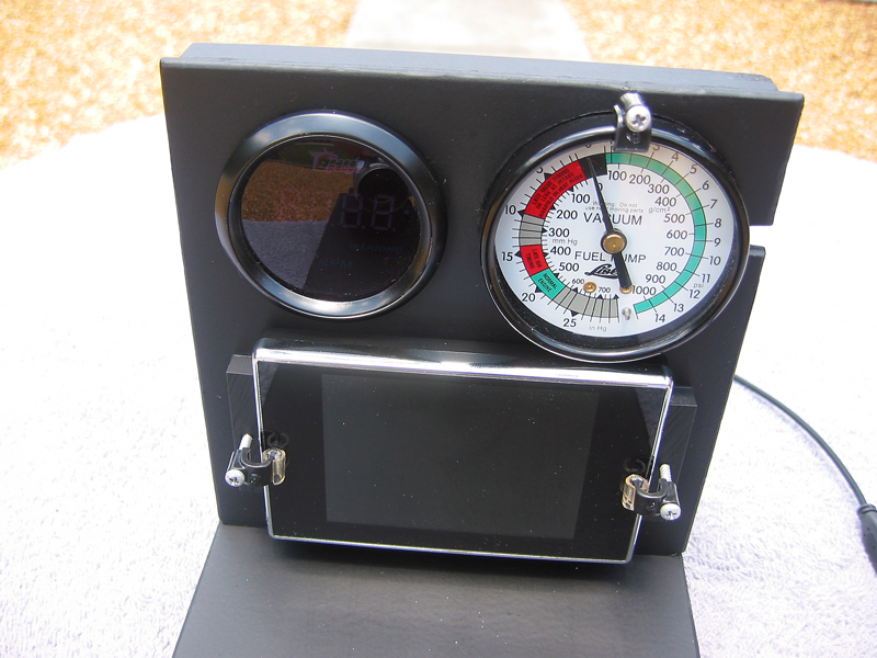

Back a hundred years ago the tuning of an engine was just making it run. 20 years later they put a lever on the steering wheel to advance the spark once they got it running. During the 30 they discovered that the ignition sydtem needed to be goverened by the load, adding a machanical advance and vacuum retard in the case of the Flathead. This along with the vacuum brake provided a well tuned engine and it still works quite well today. by the 90's, engine management systems were beginning to show up and have continued to improve the power and economy of our engines. This was an evloution that took a hundred years.
Now Hot Rodders have capitalized on the advancement in engine tuning, but only in the developing of more Horsepower. Now it's time to cash in on the economy bandwagon. My friend Richard has taken this to heart, and with his own money has buit several pieces of test equipment to monitor the FLATHEAD engine in operation. The two photos show one of them. It includes an AF meter a vacuum gauge and a video monitor that displays the timing of the engine as it runs through it's paces. This is all recorded on a video camera for later observations.
I commend him on his resourcefulness, Someone else that provides a service is Jim of Bubbas ignition service, your lucky to have someone like him around to do this because the aftermarket doesn't really help very much and is very expensive for us old timers. I'm getting old and working on this has been one of my greatest joys.

Looks Great !! I like The idea of home brew testing equipment ! The tool needs a name or
a number. BR 542 Testing Monitor ??
Here's the latest version of my "Road Rig." This one also has an A/F monitor and an enclosure to keep out daytime glare so the video tape is clearer.
The timing monitor is fed by a tiny camera attached to the timing cover and focused on the pointer and the degree strip. It works quite well so we can see the actual advance in real time and in relation to rpm and vacuum.

I would like to see a little video clip of the box in action driving down the road etc showing a/f ratio, manifold vacuum , rpm , road speed etc.....

I would like to see a little video clip of the box in action driving down the road etc showing a/f ratio, manifold vacuum, rpm, road speed etc.....
So would I!
I made some runs with the old version and they were very instructive. Unfortunately, none of that video survives.
Just about the time I had the new Road Rig ready for action, unignorable problems began to land on me and I've been digging out ever since: serious brake problem; sudden loss of power that prompted me to build my Crane/HEI ignition system; an itch to build my "Frankenstein" distributor (which is wonderful) from an '80s Chevy HEI distributor and a donor housing; then the discovery that my fuel tank was full of rust and gooey coating remains.

OK, glad to see others are picking up the torch, the more the merrier. Now rather than run through other mistakes, read JWL book "Flathead Facts" and the chapter on carburetors. He ran an EFI system during one of his tests. These things go for 1200 bucks or more, and the Edelbrock 4bl is very adjustable and inexpensive considering.
As for the videos, I have a few that Richard sent me and they are very hard to see the timing light will sync with the camera and you miss some of the numbers. also the lighting interferes with the camera. That's why the new instrument box.
However it did give us enough information about the mechanical advance and the vacuum advance. It was so nice to see the advance go to 28 degs after accelerating up to speed. Then the AF meter went from the mid 13's to the hi 15's. with no ping and 8.5CR. That was with a the T-5 and 4.10 rear. now he has a 3.54 rear.
