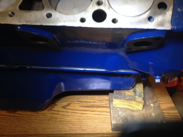

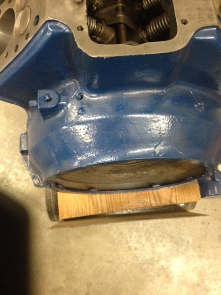

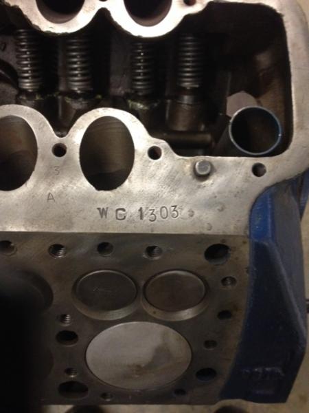

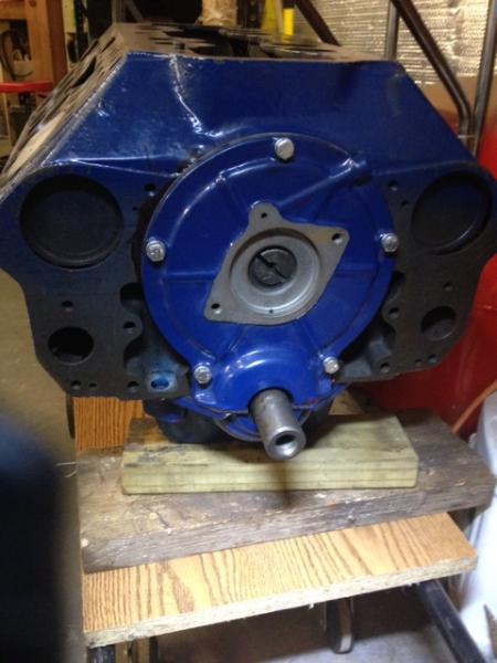

Rather than start a new thread, I figured this would be a better place.
Recently got this block and trying to ID it. From everything I can find it appears to be a 239 from a 39-41 (closer to 41?) truck based on the stamp on the left rear of the block 99T-638628 and the lower water passage.
From what I can gather this is a good block but one question is whether parts for a "59" block will fit properly.

If it has bulges on each side of the pan rail with core plugs then it is early 39/40 type. If it has no core plugs on the pan rail and has a raised appearance on the intake deck then it would be 41/42 type.
If it has the 29A con rods then it is a direct interchange for rotating assemblies with the 59 series. The 59 stuff will fit it though as long as you use all the right parts. The only real difference then would be that it has thicker cylinder walls and the earlier type valve angles.

Thanks. It has the raised intake deck and the rotating assy was swapped out of a 59 block. The valve angle shouldn't matter on the thicker block, should it?

The valve angle will depend on the heads you use. If you have and older 99, 09, 19, or 29 type block (1939 through 42 239-CID), you can either use the old original 99T, 81A (big A heads), or other early type pre-war heads that are non-59 series with no problems. If you use later 59 series heads or some of the aftermarket heads, you might have to do a little bit of relief in the valve areas of the chambers to make sure they don't make any contact in there. You can convert everything to 8BA style too if you want to use a 4-inch Mercury type crankshaft.
They used to make tools to do the valve relief work but they are getting hard to find. A little work with a die grinder might do the trick too as long as you go at it in a scientific manner.
