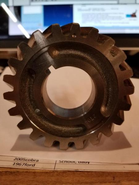

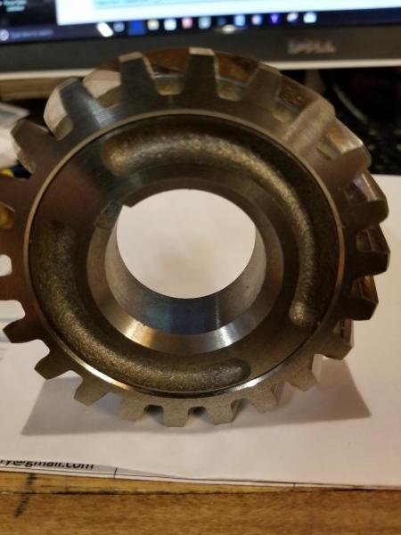

Ok, I went and pulled a gear. You can see where the mark would be. I also took a photo of the rear of the gear. The rear has a camphor that is much larger than the front side.

JSeery from what I can see the gear is on backwards as I can see the larger chamfer behind the oil slinger. So I rotated the crank until the keyway came up to about the 10 o'clock position. Interestingly enough I had suction on my finger when bringing it up to this position. Would this be correct if the cam timing was 180 out? I then marked the 3rd tooth to the right from the keyway. If I read everything everyone has been saying this is where the timing dot is supposed to be, or close to it.

Ok, redid my stuff. Used the cut out in the slinger to locate the keyway in the crank gear! Turned the keyway to the 10 o'clock position and then counted 3 teeth over and marked the gear. This should be the timing mark now. This time I had compression on #1 as I came up to TDC and the "pulley" keyway is 180 degrees to the right of the gear keyway. Approximately at 5 o'clock. Sorry for the additional confusion as I was reading one thing and doing another. My bad. If you look at the picture I have left the slingers cut out in front of the crank gears keyway and you can see it through the cut out. The dot on the cam gear is now about 5 teeth away from the new dot I made.

Pooch I think it is on backwards from looking at the crank gear pictures that JSeery posted. I can see the larger chamfer on the face of it looking behind the oil slinger as indicated in his pictures. I am just going to mark this one in the correct location and let it go at that. I still have to figure out how to get the cam to the correct place now that I have the crank location correct. Once I have that done then I may pull the heads to look into whats up with the valve springs. Some of the guys have mentioned they don't look correct.
