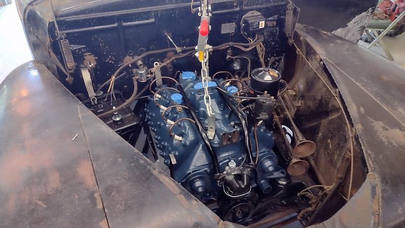

Folks,

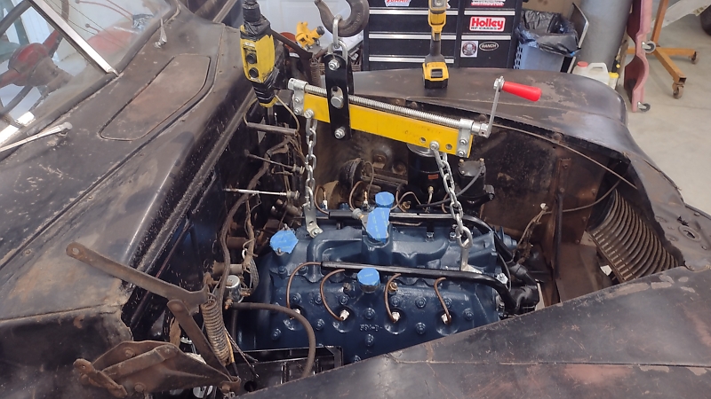

I helped John move the 42 from his garage to my place. We plan to install the fresh 59 AB engine and rebuilt transmission tomorrow.

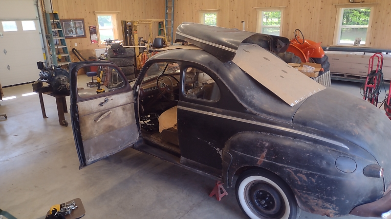

Ford folks,
John has many stories about this 42 Deluxe since he has owned it.

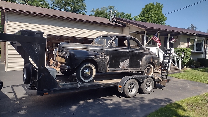

Here we are loading it for the short ride to my shop:
Trip was uneventful and the 42 will get a fresh flathead today if all goes well. We did stop and vist with our friend Ron S who was the previous owner of the flathead engine. I think he liked the 42 also.

Folks,
The clam shell area was the hardest to get the fastners in place for sure. I would say not one of Fords better ideas. But it was my first time helping in that area.

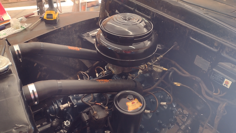

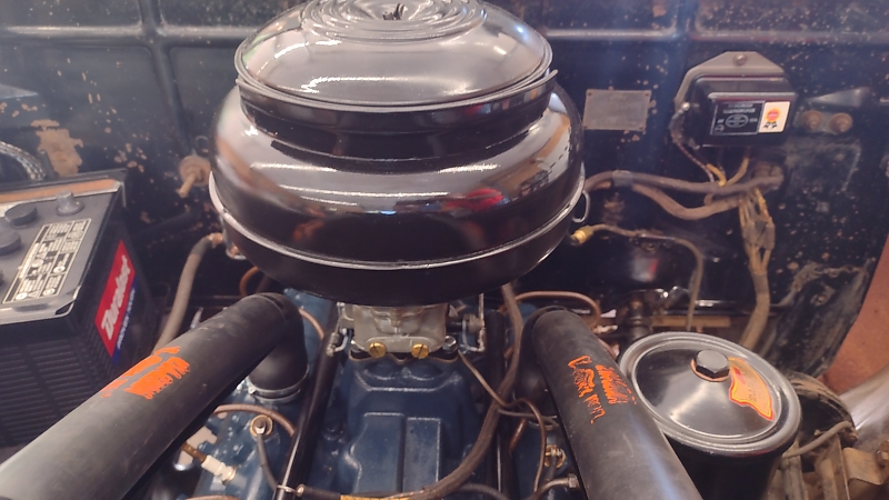

Old 06-24-2022, 06:30 AM   #66
sugarmaker
sugarmaker's Avatar
Join Date: Dec 2016
Location: Albion PA
Posts: 1,861
Default Re: 1942 Ford deluxe coupe project
Folks,

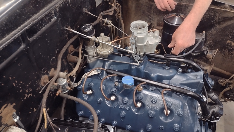

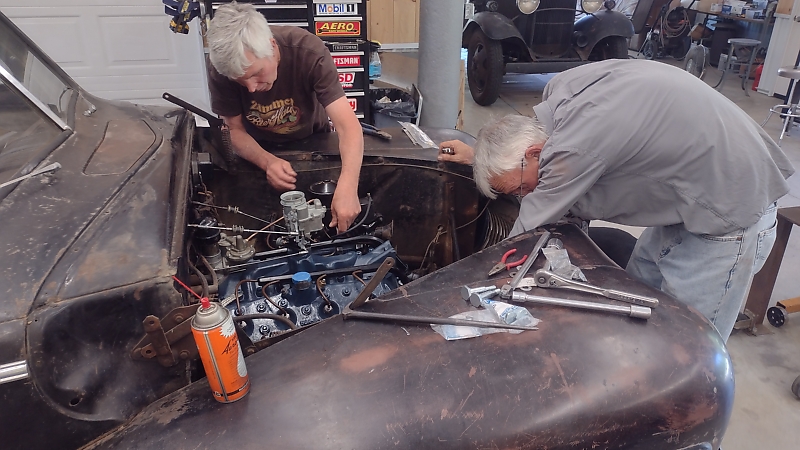

Adding a little to John's thread for him. John's brother Tom stopped in to assist him on details inside the engine bay.
I believe these are some of the items tackled yesteday. Carb attached. Fuel pump installed. rods to choke and throttle and the foot throttle in place. A interference between the oil line and foot throttle linkage was resolved by Tom gently tweeking the steel oil line out tof the way. Front engine mounts were installed and a call was made to Michael Driskell to get a quick piece of information on the front mounts too.

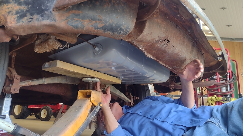

John made some additional moves on his 42 project. He tweeked the install of the new gas tank and has it ready for fuel.

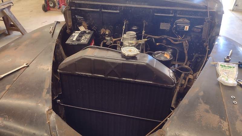

Old 06-27-2022, 05:39 PM   #77
sugarmaker
sugarmaker's Avatar
Join Date: Dec 2016
Location: Albion PA
Posts: 1,861
Bobby, Folks,
John does the work, I take the pictures! Seems to work out well! Just kidding, we help each other and its good to have a friend in the shop too. I am learning a lot about cars of the 40's too!
The radiator and its brackets, hardware, and hoses were installed by John today and it went pretty well! I assisted in a couple areas, and held some bolts from turning, provided my opinions and thoughts.

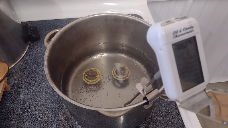

John tested his thermostats. They opened at about 180 deg F.
I believe it is ready for water/ coolant.
