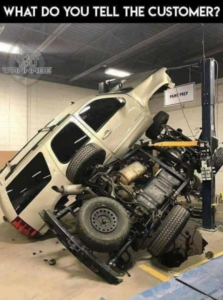

There is a weak link in many of the electric motor controllers used on many of these cheaper lifts both in 2 and 4 posts. There is an electromechanical relay used to control the ups and downs... The companies that use a Chinese made electromechanical relay have issues with the contacts welding themselves together. So sometime when you release the up lever it keeps on going up until it finally hits the safety stop. Oil change shops were getting sued when pickup trucks with tall camper shells were being accidentally shoved into the ceilings. The real high end lifts being sold typically use more expensive solid state relays that are contactless.

That is scary. I wonder if a 220v model would have less chance of that happening. Less voltage drop, less heat in the contacts, etc

This is the first I've heard of this. I have, however seen that picture before. I wasn't there when this happened but I am pretty certain that the wreck was caused by someone lifting by the body and not the frame so the weight of the frame/drive train ripped the body bolts out. Whether that is true tor not I don't know (just my observation) but I am even more certain that it was NOT caused by a faulty switch. There appears to be zero damage to the roof of the vehicle and I fail to see how squishing ta vehicle against the ceiling would cause the frame to separate from the body. Again, just my observations.
