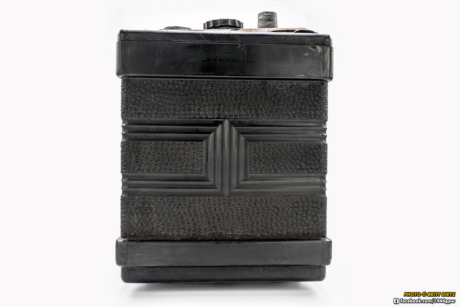

As for an update... things have been a bit slow (and will be slow as I have a busy few weeks coming up), but I did manage to finish measuring the entire original battery. And I measured it down to the third decimal point on every little bit. I even made some trace rubbings with a pencil so I have actual size references should I need them.
My thoughts:
- The battery is VERY un-uniform. There are many places where things are not perfectly sized the same. I think the original casting of the battery was imperfect, and it didn't need to be really. So that gives me a bit of wiggle room, if I need, to fudge some things as in reality, some things were off a good .15 inches depending on where you measure it. When you get down to the decimals, most things were off .01-.08 between the different sizes. That being size, I tried to find averages in those cases to come up with a number that works while also noting the differences between the various points.

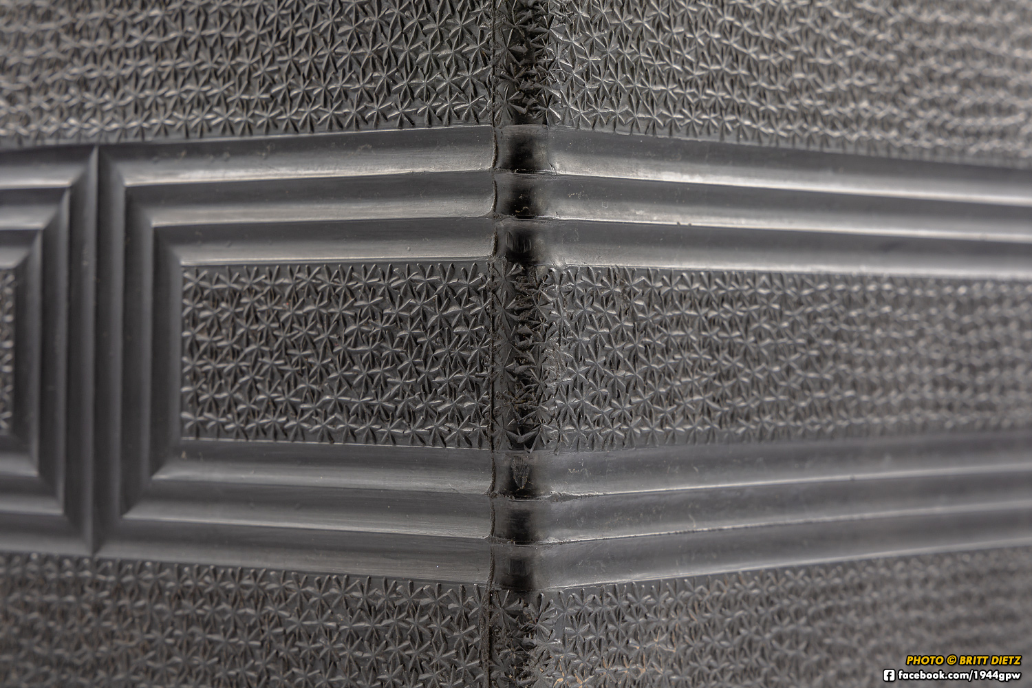

- The seams, as mentioned in my previous post, are perfectly aligned down the skinnier sides of the battery. This means that having a seam there for putting parts together will actually mimic the REAL thing.
- The star texture throughout the side walls is not in any pattern that I can see. they seem random and chaotic, sometimes almost overlapping. Where the seams are the stars are NOT aligned to continue from one side to another. Another great thing for 3D printing.
- The tar on the top of the cover is pulling upwards where the two terminals are. I assume this is from the repeated lifting of the battery by the terminals with the original (rare) battery handle they loaned me with the battery to move it. I took this into consideration and only measured the middle cell top as that one seemed to be still in its original place.
- The bottom of the battery has 'The Richardson Company' and 'Made in the USA', along with 'Patent Pending'. There's also a '4333 F' in a circle at the bottom. I'm not going to replicate those, but I did take photos and a pencil tracing just to have them.
I shot about 100 detailed shots of the battery in a mini studio-type setting. Here's a few I'll share for anyone who comes across this thread looking for photos of an original 1940 Ford Battery.

Here's the seam I was talking about and how the star texture does not align on either side:

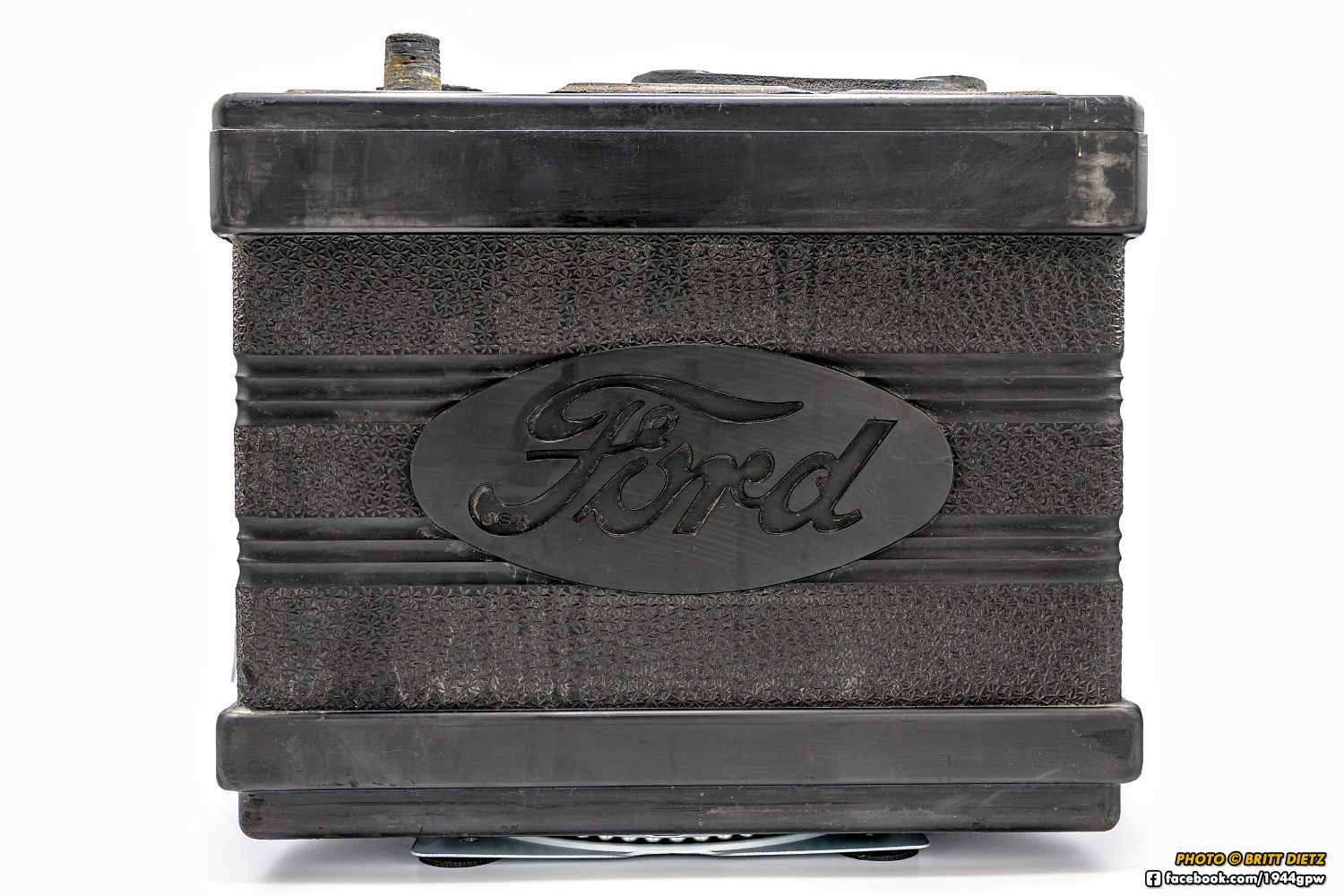

After trying thinner letters, it's still turned out pretty much the same. So I think the .2mm nozzle will make the difference here. But I did spray paint one of them with a satin black, which ended up being way too shiny. So I did a lusterless dead flat black, which might be a little too flat. So I'm going to look into a regular flat black, which often isn't as flat as a lusterless dead flat.
Here's a photo of the original cap on top, the newest printed one on the bottom left with the smaller text, and the painted one on the right. The newest printed one didn't come out as clear as the other two I printed, so I need to go back and check what settings I've changed. But at any rate, making slow progress! I'm going to work on the caps next.

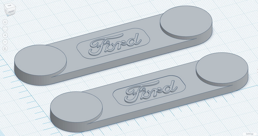

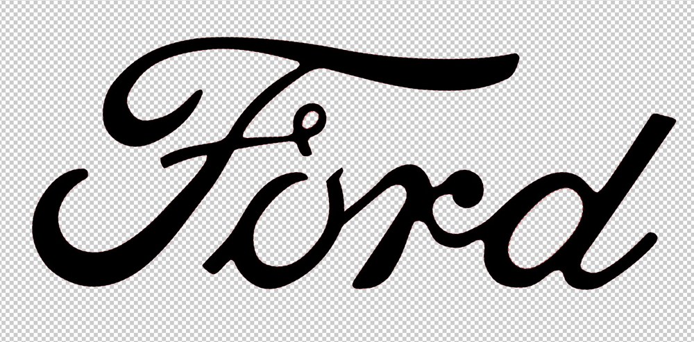

Another quick update, I thought I'd show how I am constructing things like the Ford script on the caps. So, it starts with the high-resolution photos I took of the original case I'm borrowing from the Early Ford Parts Store. From there, I manually trace the Ford script and turn it into a path.
It takes a while (and checking the photos and the original case to get all the lines right).
I then can turn it into a shape and export that through a program as a .SVG file.
Then, I can import it into my 3D program and set it to the correct size and height based on my measurements.
I even added a raised/lowered surrounding area around the FORD to mimic the raised and lowered stamping impressions on the original caps.
Next, I'll be doing a test print once I get the .2mm nozzle! Coming along, slowly, but getting there. Hopefully, I'll have this all done by next month.
