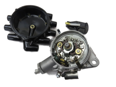

OK......I'll bite....wth is a "crab distributor" ? Or am I just a dumb bunny?

1942-46 FORD FLATHEAD rebuilt "crab" distributor

Now that's interesting......never seen one.

The crab distributors appeared after WW2 and were used through '48.

The crab cap was a short lived item due to the start of WWII. I always referred to the post war distributor as the rabbit ear design due to the cap shape with the bail. It can be converted for the crab cap pretty easily though. For a number of years the rabbit ear cap was not available in parts stores so a lot of folks converted them to the crab.
The conduits look nice but they can promote cross firing after the high tension leads deteriorate to some extent. I've seen some inventive ways of attaching the crab cap high tension leads. Some folks use the separated individual tube designs to direct the leads and others used clip type stand offs on the manifold to keep the wires separated. Most of these set ups require custom fabricated leads.

They appeared first in 1942.
