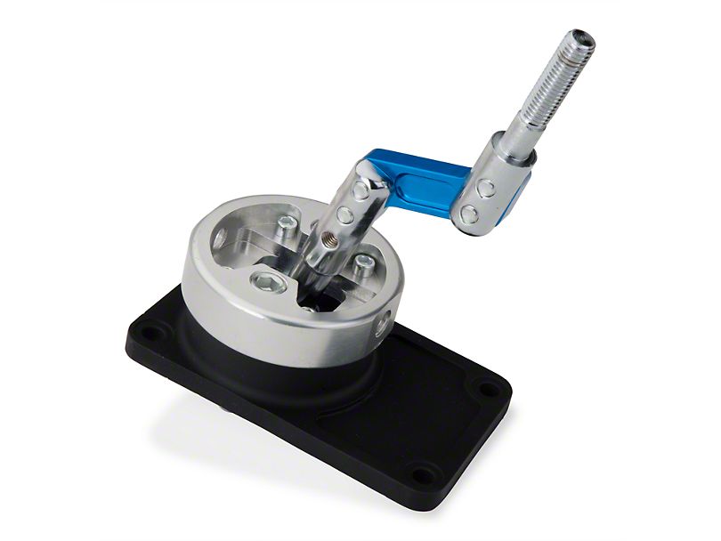

Can someone please explain the mechanics of the shifter and its twin brother as shown in post #23 ? Obviously the forward shifters position has nothing to do with the transmission itself, but I can't quite figure out the connection and mounting of the bottom portion of the "Phantom" shifter lever. Are they using a Heim joint or some other fixed mount shaft with a pivot on the end? As simple as this is, it would be a great addition to any T-5 set up and I for one would like to have this for my car. Thanks

To me, it appears that they have merely procured an aftermarket T5 performance shifter like in my picture below, cut the intended internal shifting ball from the bottom, and mounted it solidly to that makeshift plate on top of the stock shift-rail cover. It amounts to nothing more than a 2-D gimbal of sorts. DD
This is my over-complicated attempt to move the shifter to the stock location. I cut off the shift stub on the stock shifter (bottom) and then mounted the longer T56 shifter assembly and mated the two with the linkage as shown in the pic. It's basically two shifter assemblies mated as one with the rearmost shifter attaching to the transmission. It puts the shifter in the same spot as the stock 3-speed shifter.
