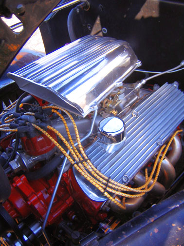

Hopefully this will work.
Sanborn,that's beautiful.
Milt/Las Vegas

Sanborn,do you have the short w/pump,I can't tell in the pic?

Yes Milt, it is a short pump using aluminum GM type pulleys. Thanks for the comment on the car, it's a "Resto Rod" similar to yours except I used the original beauty rings and Deluxe hub caps.

Sanborn,you're welcome.What chevy pulleys are you using,and what short w/pump are you using?

Milt, I am using a Milodon "short" , high flow pump. What I did was to fabricate the air conditioner compressor and alternator mounts, then go to our local oval track speed shop and start looking through pulleys. I found a bottom pulley that lined up and then chose the top pulleys to get a good 1 to 1 ratio. The pulleys are aluminum which allows some minor machine work to get perfect alignment. Plus, most oval track shops also carry the "back spacers" in .030", .060" and .090" for both top and bottom pulleys to get the alignment close. Opps, I forgot to add, the harmonic balancer is an inexpensive, aftermarket unit the has both standard Ford AND GM bolt patterns---I sorta cheated on that one.
