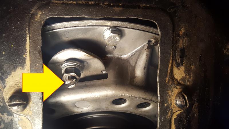

Steve at Bert's thinks the pressure plate adjusting bolt might be clipping the clutch housing. Sure enough, there is wear on one of the bolts. (see attached)
I'll grind them all down and try again. But if that ain't it, I'm drivin' it like I stole it!

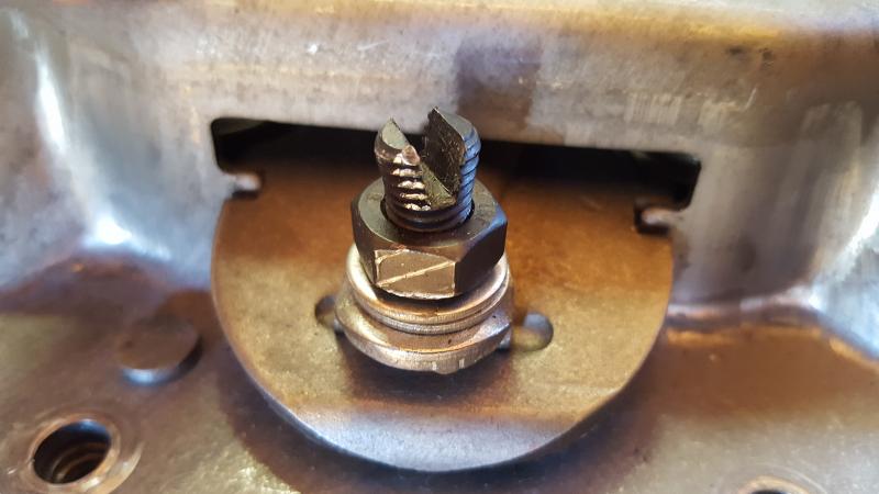

Yep, that was it! One pressure plate adjustment bolt was nicking the clutch housing. I ground them all down, and no knock!
Thank you for all the great suggestions. I love this place!
