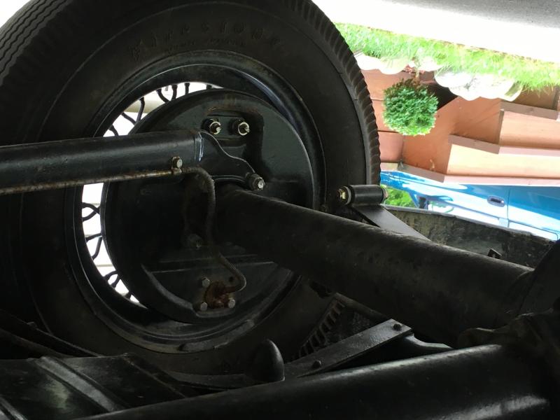

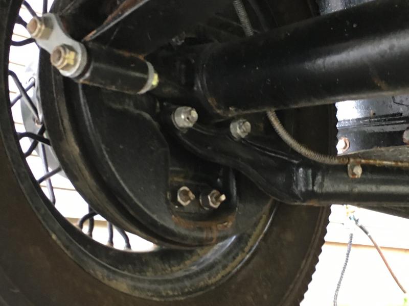

Have a look where the spring attaches to the axle. If the attachment points on the axle are part of the axle casing, it is a 37-40 axle. If the attachment points are on an extension of the radius arms and are bolted to the axle then that is 35/36.
In theory any complete rear end assembly 35-40 ought to bolt in. Obviously if it is exacly the same it may be simpler with regards to running the brake lines etc.
I meant to reply earlier to say that if you jack up the rear and pull each wheel, one of them ought to pull right out. This will confirm the broken axle diagnosis. If one does not pull right out, it may be because it is catching on the brakes or safety hubs or retainers have been fitted in the past.
One other thing, is the speedo working when the car is supposed to be, but not driving? If it is it means the problem is rearward of the gearbox, if it isn't, the fault is in the gearbox or clutch.
No harm in doing a little testing to try and isolate the problem.
If it were me and the tests show it is an axle, I would first get an axle and then only partially dismantle the left side of the casing. This would allow the diff unit and the axle shafts as an assembly to be withdrawn. they can be fitted up with new shafts and reassembled. With luck, if the gaskets do not get torn it can be bolted back together and back up and running in a relatively short time.

Thanks Mart, I will run home and take some pictures of what I have...I don't believe the attachment points are bolted on but will check. I'm certain it's a broken axle. In neutral with the engine running, there's a slow and steady clink, clink, clink coming from the rear end and when I put my ear on the axle tube, it's clear the noise is coming from within. I can also grab the left rear tire and rock it back and forth with quite a bit of movement...it never did that before.
I mentioned that this will be a driveway project but failed to mention that once the axle is out of the car, I can set up a table in the garage and work on it inside...I just can't fit the whole car in there...sigh!

Capt, if your axle housings look like these, with the angled flange welded in place like these for rear wishbone attachment, then you would have a '35-'36 rear.

First batch of pics

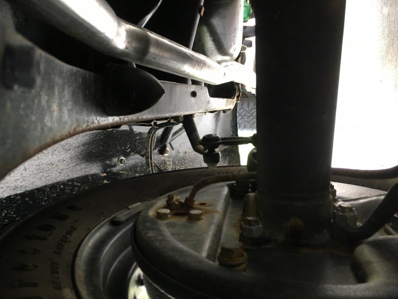

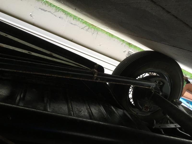

Last batch of pics. I measured from the face of the backing plate to the banjo flange and if memory serves, it was 24 5/8"
