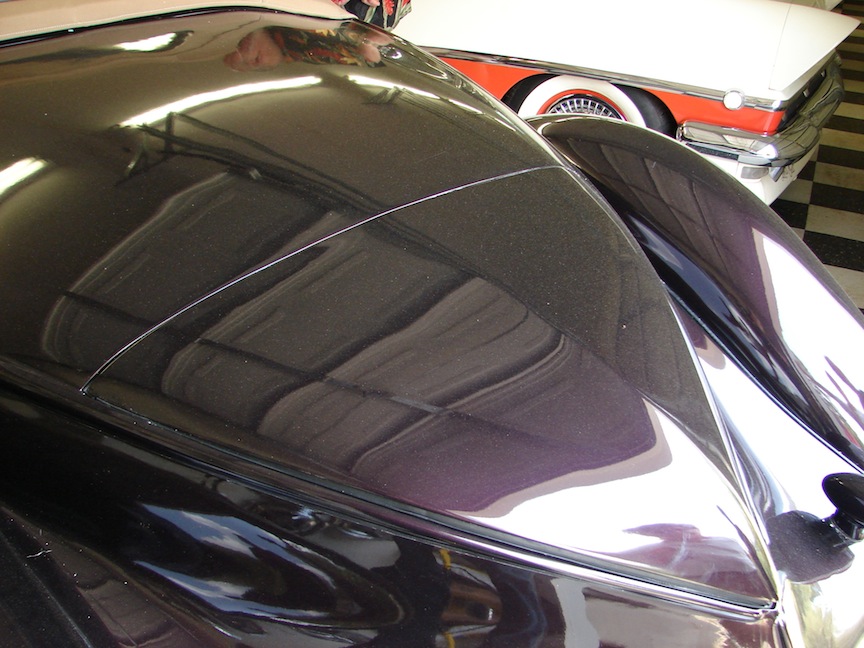

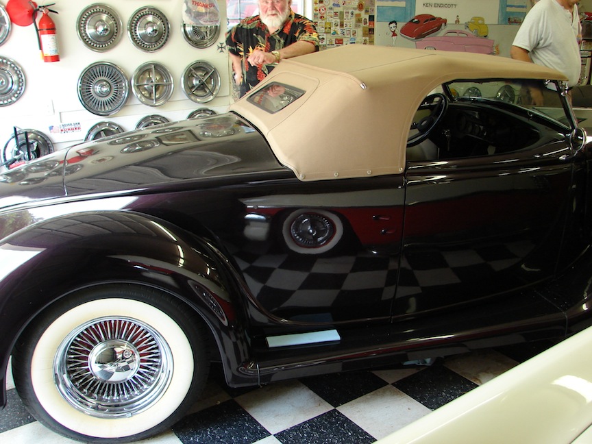

Turns out that the purple boattail that is in the photo we have of cars produced from our molds is two hours away from my house.We went over and met the gentleman that owns it and turns out he has an awesome collection of customs and we spent the day there.His boattail has a 1935 Ford front end and is very well done. The doors shut shut like a metal car and the fit is great. This is starting to be fun.
Here are some shots.
[IMG]http://www.hotrodsonline.com/Photos/...oattail04.jpeg[/IMG]
[IMG]http://www.hotrodsonline.com/Photos/...oattail06.jpeg[/IMG]
[IMG]http://www.hotrodsonline.com/Photos/...oattail02.jpeg[/IMG]
