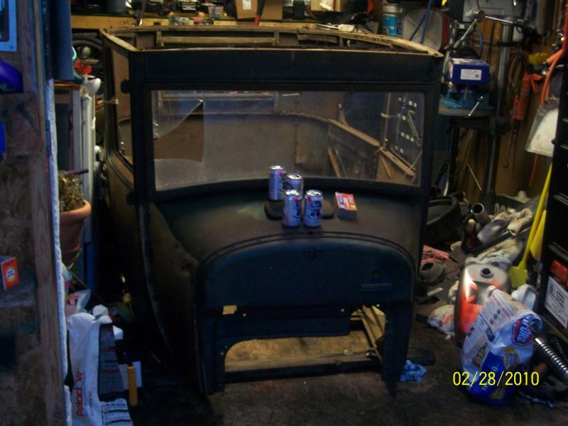

Here it is. Bought this a couple months ago. '27 Sedan. Gonna basically restore the body. I will, however, do an unusual top insert. Top secret stuff, there. 2x4 frame, channeled 4". Flat front cossmember w/spring behind axle (mounted to split 'bones. Stock Model A rear crossmember. Gonna be low without the aid of a dropped axle. '36 Ford front, '55 Chevy rear axle (freebie!). Juice brakes (40's ft, '55 Chevy rear), steel wheels and bias plies. Scored a Studebaker 289 last week. Has a T10 bellhousing on it so I can park a T5 right there. Engine runs great. Pretty excited about this build. Gonna be fun.

Is it going to be powered by the stuff in the four cylinders sitting on the cowl?
