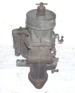

1932-1933 Ford Carburetor - Detroit Lubricator - Single Barrel

The picture of the Detroit Lubricator carburetor is for 1933. The 1932 model did not have the hand choke linkage on the passenger side.
