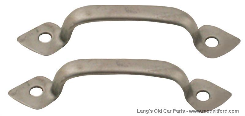

Originally Posted by Neil Wilson View Post
Does anyone know of a source for the open rivet?
There isn't any rivet. When the handle is made, there's some 'meat' that gets peened over once the handle is installed on the side panel.
I just did a set of Model T hood handles and this is how they were, and originally too for that matter.
This pictured doesn't show the backside, but it gives you an idea.
http://www.modeltford.com/i/c/476403l.jpg

Thank you for the information. It is great to know that the early handle does not have a separate rivet.
While nobody confirmed that the T and A handles are exactly the same, I get the sense that they are (which makes since).
It would be interesting to know if the JS is correct or not about the handle conversion being "after April" in stated. My early Feb. 28 truck had the later style handles on the early hood. I believe this was the original hood based on the rest on the truck (but no way to verify that).
I guess I will just order a set of handles from Lang's and go from there.

Neil,
The Lang's handles do have the extension. I used a pair of them on a customer car a couple weeks ago. They work well.
