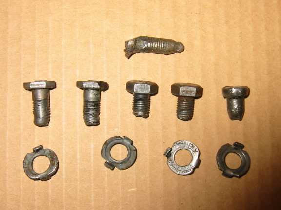

Jerry Parr WI 07-17-2012 09:46 AM
Re: Loose screw in bell housing
The danger is a bolt trapped between the flywheel and the bell housing breaking the bell housing. I had one trapped between the flywheel and housing that even with the engine out could not be removed until I took off the flywheel. In addition to the problem bolt this collection was left in the housing by previous owners of the car.

29FordGuy 07-17-2012 01:26 PM
Wow, that is impressive. Quite a collection of junk. I know mine only has the one screw and lock washer. I just hope mine is resting quietly on the bottom where I can pick it up with a magnet. I don't want to drive it until I get the thing out!
