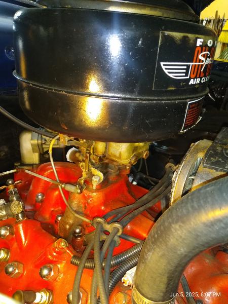

Attachment 585546 I have a 52 2dr and my engine is either orange or red I can't tell. I am partially color blind.

Looks orange to me which is correct for 52. Not sure it is "Ford Orange" in the pic. Chrysler and Ch - - - used an orange also.

1952 was the change over to the EAB engines which had the rotator valves carried over from 1951. The EAB had a little bit higher compression heads and a cam change to increase performance with the changes in the fuel available. The competitions higher performance overhead valve V8s were affecting the numbers plus more folks wanted the automatic transmissions. Ford knew that the flathead V8s days were numbered but it took them a while to design their own overhead valve V8 for lower cost production. The 215 Ford 6 and the Lincoln 317 were out already but the Ford and Mercury V8s were still in development.
Ford always used color to identify V8 engine differences in the 8BA era that began in 1948 with the introduction of the bonus built trucks.
