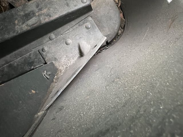

Randy in ca 08-03-2025 12:46 AM
Re: 1931 roadster pickup
1 Attachment(s)
I think what you're looking for is just shown in the lower right corner of Charlie's first picture:
https://www.fordbarn.com/forum/attac...8&d=1754199789

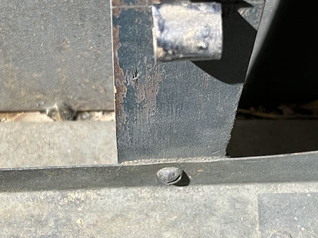

Charlie Stephens 08-05-2025 06:08 PM
3 Attachment(s)
Now I understand the confusion. First photo is from you of the subject part. The remaining ones show the part installed on my truck.Thee two large holes missing on your part were probably for tooling to locate the metal. The 3 holes not drilled on your part are to attach the parts to the sill. In addition one small screw hole needs to be added for a screw that passes from the door jam, thru the wood and is attached with a small nut.
