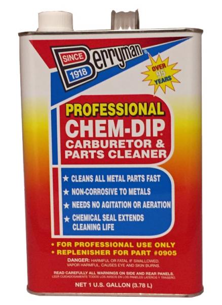

Good old smelly Berryman carb cleaner. I haven't bought any in 10 years so I suspect any sold in CA today won't work.
Gene F 11-08-2024 02:02 PM
Re: Solution for soaking Zenith Carb
ModelA29 I have used this. Smells to high heaven just taking the lid off.
So true, unfortunately. “California compliant” means twice as expensive and half as effective. Doesn’t matter whether it’s carb cleaner, brake cleaner, automotive paint or even portable generators.
I’ve used recent Berrymans and it works, sorta, but not nearly as well as the stuff we geezers grew up with. That stuff would take even the gunkiest, most varnish ridden carburetor and return it sparkling clean. New stuff, yeah, it loosens the goo but you have to scrub like hell to get it out.
And don’t get me started on Brakleen. The new green can “50 state compliant” stuff is basically acetone. Fire hazard and it evaporates immediately. I periodically find the old red can stuff in gallon jugs on the river store, so I buy it and put it into a compressed air sprayer.
Gene F 11-08-2024 07:24 PM
JayJay my old 5 gallon can I am still using. That stuff is so wicked the bucket finally began to seep just a vary little bit. Replaced it one after that two, so I am on bucket #3.
JayJay 11-08-2024 07:51 PM
I now buy new stuff in one-gallon steel buckets with a dip tray because I had the same thing happen - the stuff rotted out the bottom of the bucket. I do like having the little tray that comes with it. And admittedly, I tend to use the stuff only every several years, but I accumulate a bunch of parts and run them all through at once. But it's not as easy to find as it once was, a lot of the auto parts stores have stopped carrying it. Part and parcel to today's "replace rather than repair" philosophy.

Berryman sold anywhere doesn't work anymore. Good friend builds lots of carbs and uses Zepresto. Expensive but works. Agree on Rust 911. Works better/faster/longer and is much cheaper than Evaporust.
