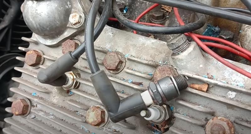

Mart 10-05-2021 06:12 PM
Re: Help I知 Lost
1 Attachment(s)
Do you have spark if you fit a plug to one of the leads outside the engine?
Like this:
https://www.fordbarn.com/forum/attac...9&d=1633475491
34 fordor owner 10-05-2021 06:56 PM
Re: Help I知 Lost
Like this:
I tried this on the number 5 spark plug and I did have a spark. Tomorrow I plan to check others. I may even do the spark plug wires over again to ensure I have them correct.
