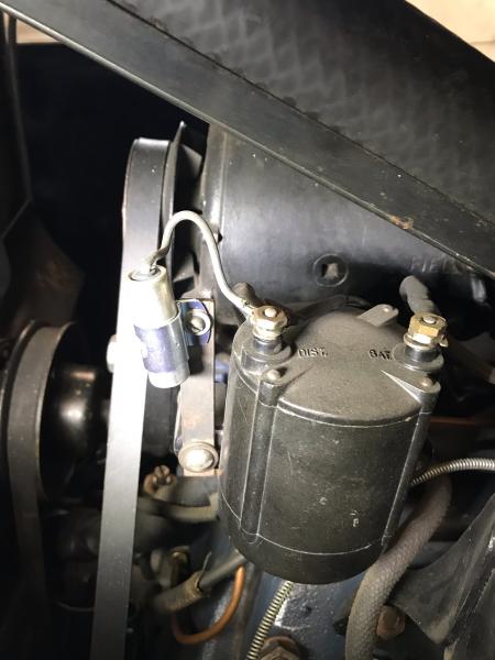

oldford2 05-24-2020 07:58 AM
condenser re-locating to coil
1 Attachment(s)
I received a PM from Moe up in Canada on details for moving the condenser up from the distributor to the coil. I tried to reply to his PM but there is no icon for attaching pictures in a pm (?) so I am posting it here in the forum for all. Make a piece of steel about 1/2 by 3 and drill a hole at the bottom and one at the top. Remove the condenser from down at the distributer. Mount the strip to the bolt that holds the coil. Then connect the condenser to the coil terminal that goes down to the distributer.

Yea, I want to do that too! Went to remove my condenser today, and what a pain to get to it! (on a 37, on an aftermarket Mallory crab, with an electric fan in the way)
Anyone know of a downside to mounting the condenser off the remote coil like that?

Sorry. I think there's probably only an upside. 8^) Jack E/NJ
oldford2 05-25-2020 07:14 PM
Re: condenser re-locating to coil
This was brought up some years ago by 42 guy who raced flatheads. Some electric guys thought that because of the distance there was some drop in mili??? Bottom line was that for drivers this was a good re-location. The first time we have what we think is sudden ignition problem we take the first and easiest try which is to replace the condenser. Many times that is the answer. On the side of the road at night this is no fun.
So my opinion is there is no downside. My 46 has been like that for 10 years and the one time it started bucking and running poorly a new condenser took care of it. Easy change.
John
tubman 05-25-2020 07:47 PM
A longer lead does add to the capacitance. If you look at a high-end condenser tester, it will have special short leads to be used when testing condensers for exactly this reason. Most Mallory distributors have a brass strap for connecting the condensers. Even with all of that, it probably doesn't make enough difference to be concerned about.
Given all of that, if you are making a longer condenser lead, use at least 12 gauge wire (10 is even better but sometimes a little unwieldly).
