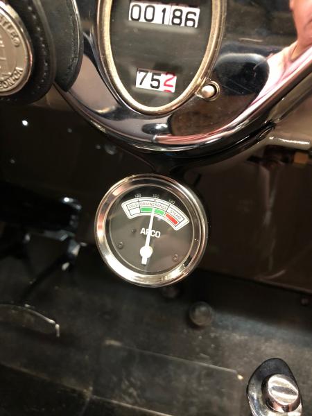

Temperature Gauge
1 Attachment(s)
Decided to install one of these gauges, so cool highly recommend it.

I feel that a temperature gauge is the most important gauge to have .

Installed one this weekend. I found that the thermo qual is accurate although the gauge is more responsive.

No harm meant but not all of the thermoquail caps are accurate . The two that I have are not accurate. . Ive found that the flip top radiator caps are mostly good for ruining the radiator neck . I'm pretty sure that all of the temperature gauges aren't accurate either . I do prefer a gauge mounted inside the car where it is easy to read and out of the weather ...

Personally I don't trust a Thermoquail or Motometer as they are 'measuring' air temperature above the coolant. The bulb is not submerge in the coolant. I have always had good luck with SW gauges, plus I prefer the 270° dial.

Altho I like the look of the Quail or the Motometer, I went back to a plain cap because the locking cap is junk (from Vintique of course) and as Purdy pointed out, damages the filler neck.

Good to see these reviews. I like the quail look, was thinking about getting one. Temp gauge is a great idea, but I don't like the placement - spoils the look of the dash panel. Not too many options, though. Maybe I can figure out how to mount it on top of the radiator cap....

Your right, it does spoil the look on the placement on the dash, i do like the green and red on the gauge though.

Have an arco temp gauge. According to two ir guns it reads 20 degrees high.
